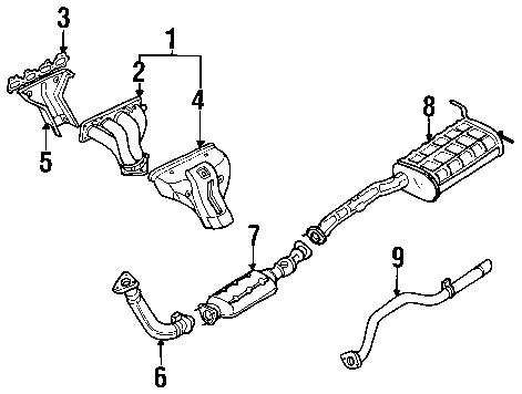

There are two variations of the Manifolds used on the fe3n in the Kia Sportage. I found this picture on a parts website. This appears to be a 4 into 1 header from the '95 to '98 model years. '98 through '02 use a cast iron manifold.

Awesome! I didn't know what they looked like or what variations there were. Good info! :-)
You say "this is the 4:1 from xyz year the other was cast" but both are 4 into one, and you supply pictures of one cast and one not. Care to clarify?

&es, sorry about the mix up. The tubular header style manifold without a catalytic bolted directly to it is from the '95-'97 Sportage. The '98-'02 Sportages have a cast iron manifold which has a catalytic bolted directly to it. I think the factory header could be used in for a turbo. I would like to find one these cheaper than the $212.00 price the parts website wanted for theirs ans see what it would take to make an adapter flange for the turbo.
